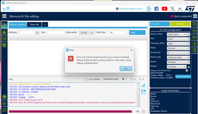

2025-04-27 7:19 AM
Ooo.. target : 0,52V - that cannot work !
power your target to 3v3 and try again. (or you forgot to connect the vcc sense to st-link ?)

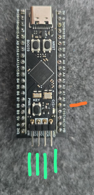

2025-04-27 8:21 AM - edited 2025-04-27 8:26 AM
Well, you NEED to power the interface, for sure. The error's complaining that the interface to the device is non-responsive.
You haven't really described WHAT you've wired, there's a picture I unpacked enough to see you didn't power the ST-LINK properly, which is consistent with the failure, provided you've connected SWDIO, SWCLK, NRST and GND properly
2025-04-27 8:42 AM
i have conected3.3v, gnd,swdio and swclk the first times, the green marks in the image, i have also tried adding reset pin with the mode in under reset, but still the same error, also tried conecting to an external power supply with gnd conected and also with the usb also conected. I have always programed with just vcc gns and dio and clk and have no problem.today its when it stop working with all my boards, i have tried several like blue pill, black pill, stm32h723vgt6,stm32wb55cbu6 stm32go no one works at all, they can conect via usb to the cubeprogrammer and it works, but i need the debuger in the cube ide

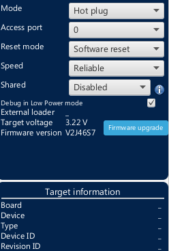

2025-04-27 9:15 AM - edited 2025-04-27 9:17 AM
Did you try other wires ? Try...
And check : just connect any powered board, only : GND + 3V3 to st-link.
You should see the "Target voltage", when st-link is detected:
If not...st-link has a problem.
