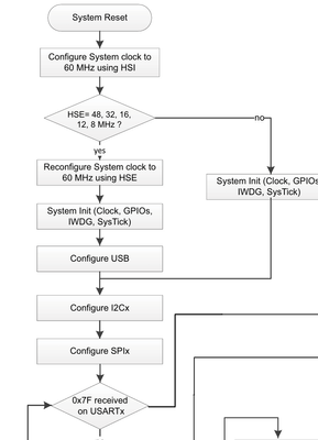

The explanation of boot mode behavior may be found in AN2606. Please Read The Fine Document.
2024-11-29 3:55 PM
Thanks a lot for pointing me to this document !
Indeed it mentions that the pin is used as SPI2 MISO in push-pull, pull-down mode, but set to 3.3V "on the bootloader start-up after SPI initialization as soon as the bit DMATx enable on SPI CR2 register is set to 0x1"

As you can see this pin is used not unused, then for bootloader using you need plan pins in app or create own custom bootloader. Too on some ST bootloaders is initialized pins not listed in AN2606 ...
2024-11-30 2:32 AM
In many cases, it's better to write your own bootloader over which you have full control, rather than trying to work around the peculiarities (not always well documented) of the default one.
