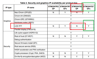

Simply because STM32H7S3 doesn't have LCD-TFT interface which is not the case of STM32H7S7 (the one used on the DK board):
From the datasheet:
2025-01-03 2:36 AM - edited 2025-01-03 2:44 AM
From the datasheet:

Hi Soflit,
Your absolutely right. My mistake.
Thank you.
