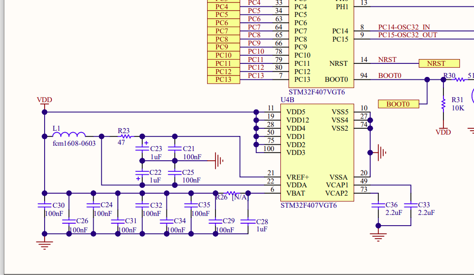

I am designing a custom board based on the STM32F407G and need to provide backup power to the VBAT pin using an external battery. my board board must comply with EMI/EMC standards, what are the key requirements and design considerations when connecting the external battery to the VBAT pin?

Have you studied Application note AN4488, Getting started with STM32F4xxxx MCU hardware development:
@rohithinthingstech wrote:my board board must comply with EMI/EMC standards, what are the key requirements and design considerations when connecting the external battery to the VBAT pin?
It's just another digital power supply pin - so the same principles as any other digital power supply pin?

EMI - make sure it does not radiate.
EMC - make sure it is not susceptible to emissions...
Given that a battery doesn't have oscillator - might be safe...
"Susceptible" - might be safe there too...
I hope that helps.

"EMC" = Electro-Magnetic Compatibility = both emissions and susceptibility.
2024-10-25 2:27 AM - edited 2024-10-25 2:28 AM
@Andrew Neil they are two separate tests, conducted independently...
Kind regards
Pedro
2024-10-25 2:33 AM
Yes, Emissions & Susceptibility are separate - but the combined total is EMC.
Compatibility consists of both not causing excessive Emissions, and not being excessively Susceptible to incoming interference.
