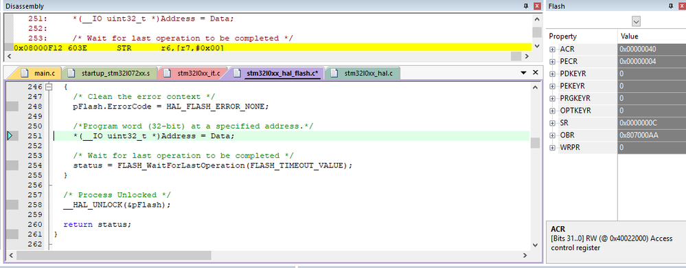

2019-01-28 5:24 AM
Hi Clive,
I'm using STM32L072CZY6TR, The Memory I'm trying to write has a value of 0x00 and while loading the address it's going to hard fault. I had tried to pull the Lock/unlock out of loop but the issue didn't resolved. I'm sharing the debug screen with register values.
2019-01-28 5:44 AM
The processors R7 register would be of particular interest here.
Perhaps use the EEPROM functions
#define FLASH_DisableRunPowerDown HAL_FLASHEx_DisableRunPowerDown
#define HAL_DATA_EEPROMEx_Unlock HAL_FLASHEx_DATAEEPROM_Unlock
#define HAL_DATA_EEPROMEx_Lock HAL_FLASHEx_DATAEEPROM_Lock
#define HAL_DATA_EEPROMEx_Erase HAL_FLASHEx_DATAEEPROM_Erase
#define HAL_DATA_EEPROMEx_Program HAL_FLASHEx_DATAEEPROM_Program
HAL_FLASHEx_DATAEEPROM_Unlock();
HAL_FLASHEx_DATAEEPROM_Program(TYPEPROGRAMDATA_BYTE, EEPROM_START + addr, (uint32_t)data); // Iterate use WORD/HALFWORD as appropriate
HAL_FLASHEx_DATAEEPROM_Lock();
2019-01-28 9:38 PM
This worked but what was the problem? I have not understood.
