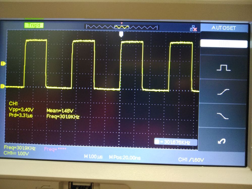

2019-08-29 2:17 AM
Hi Clive ,
I'm toggling the GPIO pin for 50us using above function given by you.but i'm not getting the exact delay .
Please let me know how to fix this???
2019-08-31 5:25 AM
Don't You see that Clive's code actually waits clock ticks not microseconds?
2019-08-31 6:49 AM
That, and one might have to compensate for cycles eaten entering/exiting.
I would tend to use precomputed constants so as not to repeat the math.
Also your wave-form doesn't look 50/50, so clearly doing something else there that you need to adjust/compensate for.
Hard to understand what exactly you're doing when you fail to provide code.
