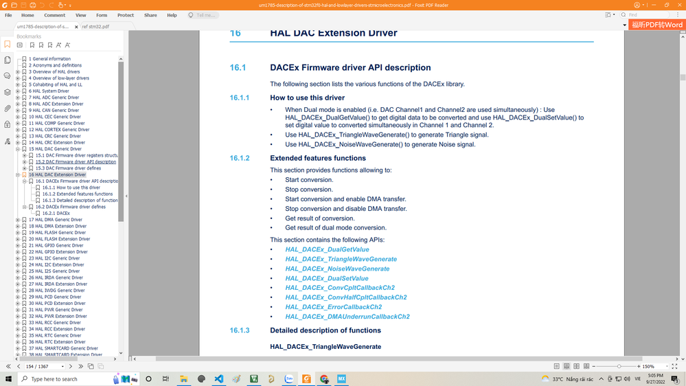

I want to create 2 analog output (DAC) on PA4 & PA5 pin. How to make DAC dual mode as instructed in refmanual? When I use template code and add 1 more DAC channel but no success.please help me how to make 2 DACs simultaneously.
Thanks
