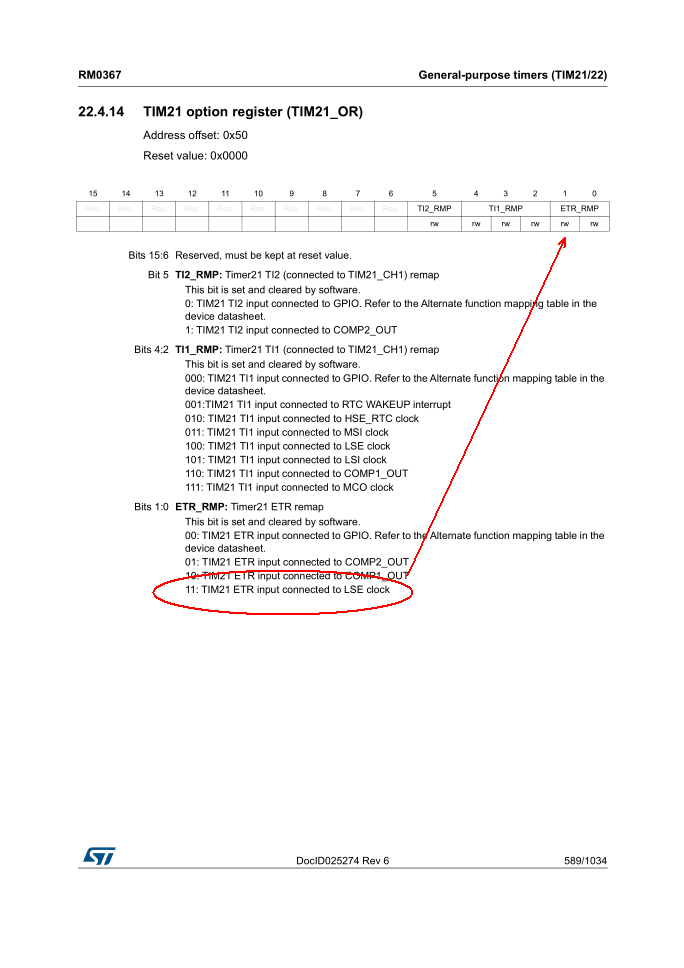

First question: how to drive TIM21 from 32KHz? The documents (RCC chapter, 7.2.16) says:
In a number of applications using the 32.768 kHz clock as RTC timebase, timebases completely independently from the system clock are useful. ... For this purpose, the LSE clock is internally redirected to the 3 timers’ ETR inputs,Looking at Figure 18, available clock inputs for TIM21 are MSI, LSI, HSE_RTC and LSE. And in the TIM21 Clock Selection description (22.3.3), it says that in "External clock mode2: external trigger input (ETR connected internally to LSE)".
Question 1: must I do anything special to connect ETR to LSE? Or is it sufficient to select External clock mode 2?
Question 2: Is it possible to use the STM32CubIDE Device Configuration Tool to configure TIM21 this way? (I don't mind writing the code myself; I have a somewhat academic curiosity to see how far I can push the design tool...)
Who cares?
Btw., you can also remap LSE to TIM21_CH1 in TIM21_OR.TI1_RMP, and then use it in the Slave-mode controller set to External clock mode 1; but the result is the same.

> If I run TIM21 in slave mode, can I still use its output to clock TIM22 (also in slave mode)?
Yes. But using ETR and External clock mode 2 is equally good.
