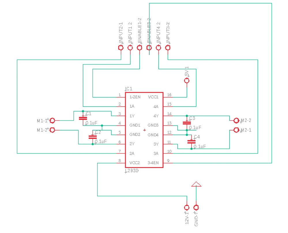

As you can see in the above image, I'm trying to design a motor controller. But pin 16 of L293D requires a 5v input as VCC1 but the maximum output a STM gives is 3V. I wanted to know how to convert and map the 3V to 5V using a passive component?

Hello @Killstreet30 (Community Member)
The best is to use voltage level translator to interface STM32 with L293D driver.
A 8 I/O's level voltage translator IC:
https://www.st.com/en/interfaces-and-transceivers/st2378e.html
Or here using transistor:

That 2nd link, the npn + MOSFET level shifter should have a resistor in series with the npn's gate.
