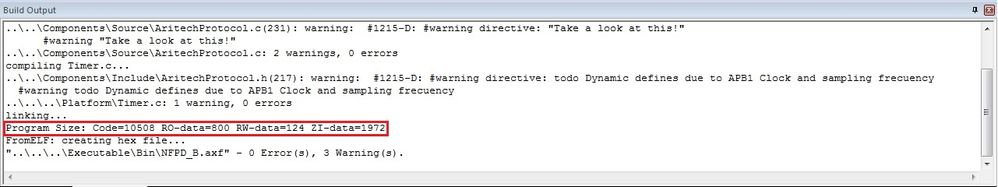

I´m developing an application in Keil uVision and I am getting this message.What does this parameters mean?Program Size Code = ¿Flash?RO-Data = ¿?RW-Data = ¿?ZI-Data = ¿?2014-12-11 6:00 AM

Code - Executable Instructions RO-Data - Read Only, Constant data/arrays RW-Data - Read Write, Variables in RAM with values ZI-Data - Zero Initialize, Variables in RAM which are zero/cleared The FLASH foot print is the combination/sum of Code+RO+RW, the RW data is there because the startup/run-time has to copy it from fixed ROM into uninitialized RAM, the zero memory is just described and cleared by the same code. The RAM foot print is RW+ZI2014-12-15 12:42 AM
