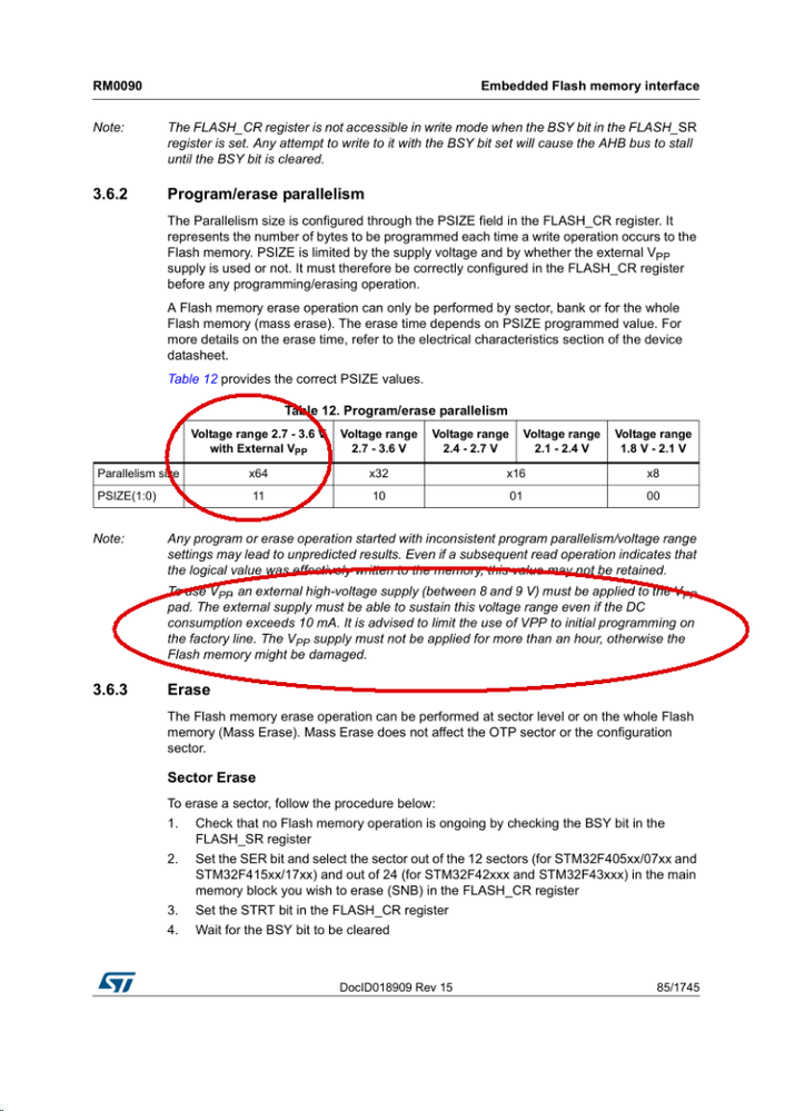

PGAERR flag is raised.
If I try to send 32bit variable it works, but with DoubleWord I get error.
No errors after erase operation.
2018-07-12 12:31 PM
Do you have the external Vpp applied?
2018-07-12 12:31 PM
