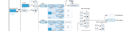

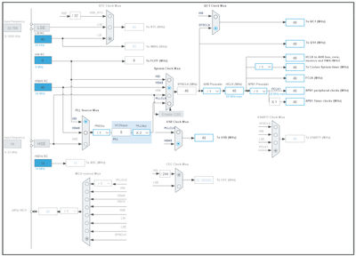

So, after almost half a year of arduous blood, sweat and tears I have managed to scrape together "something that works". It consists of a custom schematic and PCB powered by an STM32F042C6T6 and an Si4705 radio tuner (from Skylabs).

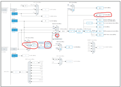

The STM32 uses the internal clock circuitry that is configured as depicted here. The CRS sync source is not shown here, but it is set to USB, so that the chip runs completely without any external crystals. The USB 2.0 is full-speed since the STM32 is only full-speed:

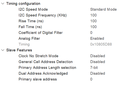

The STM32 commands the Si4705 via I2C, without DMA, and this communication works just fine. The relevant settings are shown below:

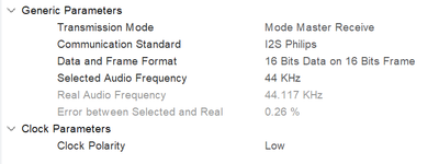

The STM32 also uses I2S and DMA to transfer data, and its settings are as shown here:
There are also several other settings that are related, and which can all be adjusted:

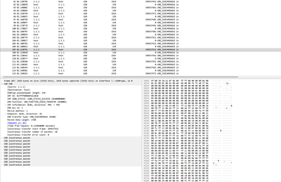

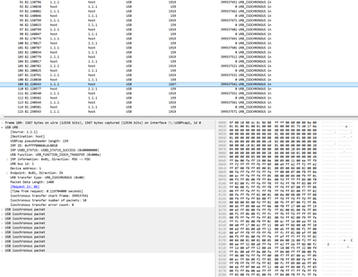

If I look at the Wireshark output I see an almost-clear recurring phenomenon: the device first sends approximately 22 frames with 1760 packet data length (10 microframes), then several frames with 1056, 880 or 1584 data lengths, before resuming with 1760 ones. Even these "shorter" packets claim to have 10 microframes in then. This repeats around every 22-24 frames but sometimes there's up to 30 "clean" frames before the shorter ones occur again.
This looks like a a bus saturation issue to me, with the host side unable to keep up. What kind of things I could do in order to try solving this? I know I am not far off from the result.

After some creative tinkering with the clock settings shown below
I managed to obtain an exact 48 kHz "real audio frequency" for the I2S. This has reduced stuttering quite a bit but I still hear occasional blips here and there.

However, my first task at hand is to identify the root cause of the problem. Why is the host receiving smaller-than-defined packages every 24-30 frames in Wireshark? I have tried switching USB ports and using a different cable but this did not affect the outcome.

In Wireshark, the packet is now staying near-constant 1760, with an occasional blip down to 1408 (which is then audible as a stutter). I must be getting close. If only I just could understand better what the system is doing as a whole...

I have set the tuner to 48k / 16b stereo but this did not fully resolve the issue. The approach is not optimal either as the "real audio frequency" in STM32CubeIDE is now 48387 Hz, and the tuner chip has a max value of 48000.
When I look at Wireshark now things have now turned around, and I mainly get isochronous packets with data length of 1920. This seems correct as (48000 * 2 * 2) / 1000 yields 192, and the USB driver on the host computer uses 10 ms buffers.
Occasionally, however, I see a solitary packet with data length of 2304. I interpret this so that the device is now sending too much data compared to what the host is expecting. This extra size is also audible as a small blip in the audio stream.

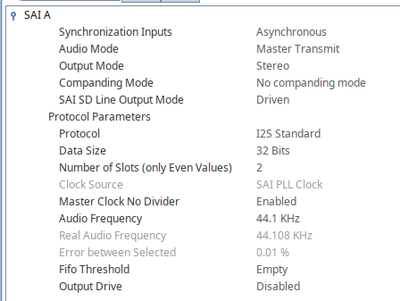

2025-09-28 1:44 PM - edited 2025-09-29 12:17 AM
On this F042 you cannot do much , its a 2$ cpu, so what you expect ?
Not even a more complex PLL here, see my setting on H743 for 44.1kHz generation from 8M HSE :
giving: very close to 44k1
also 48k can be quite good:
But still you have to do some re-sync to the PC "48kHz" USB clock.

If you want try with 48k I2S on this tiny chip, try using a HSE crystal, 12.288 MHz , HSI 48M for the USB and PLL x3 ( ~ 37 MHz core clock); check/try clocktree setting this in Cube and see: will Cube tell then 48k rate on I2S with 48k setting ? If ok, try to use some thin wires and your soldering skills and set I2C on ...other pins, HSE crystal 12.288M and 2 x12pF caps (or something similar) as HSE.
