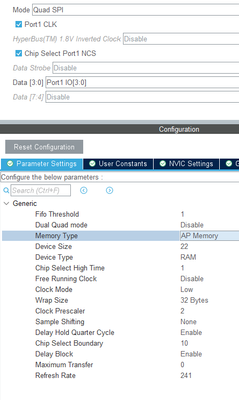

2024-08-19 12:13 PM - edited 2024-08-19 12:54 PM
None of your suggestions meet our expectations.
- The DLYB_OSPI_PSRAM_ExhaustiveTuning example, our STM32H7B0VBTx has no DLYB option.
- The project use an APS6408L but we use an APS6404L-3SQR-SN has only 4 data bits.
- OSPI examples with STM32H7 examples is for HyperRam chips and not QSPI
What we must change in the sCommand? (we want to use it in memory mapped mode)
See code below:
void EnableMemMapped(void) {
OSPI_RegularCmdTypeDef sCommand;
OSPI_MemoryMappedTypeDef sMemMappedCfg;
sCommand.FlashId = HAL_OSPI_FLASH_ID_1;
sCommand.InstructionMode = HAL_OSPI_INSTRUCTION_4_LINES;
sCommand.InstructionSize = HAL_OSPI_INSTRUCTION_8_BITS; ==> 4 of 8 bits
sCommand.InstructionDtrMode = HAL_OSPI_INSTRUCTION_DTR_DISABLE;
sCommand.AddressMode = HAL_OSPI_ADDRESS_8_LINES; ==> 4 or 8 lines
sCommand.AddressSize = HAL_OSPI_ADDRESS_24_BITS; ==> 24 or 32 bits
sCommand.AddressDtrMode = HAL_OSPI_ADDRESS_DTR_ENABLE; ==> ??
sCommand.AlternateBytesMode = HAL_OSPI_ALTERNATE_BYTES_NONE;
sCommand.DataMode = HAL_OSPI_DATA_8_LINES; ==> 4 or 8 lines
sCommand.DataDtrMode = HAL_OSPI_DATA_DTR_ENABLE; ==> enable or disable
sCommand.DQSMode = HAL_OSPI_DQS_DISABLE;
sCommand.SIOOMode = HAL_OSPI_SIOO_INST_EVERY_CMD;
sCommand.Address = 0;
sCommand.NbData = 1;
/* Memory-mapped mode configuration for Linear burst write operations */
sCommand.OperationType = HAL_OSPI_OPTYPE_WRITE_CFG;
sCommand.Instruction = LINEAR_BURST_WRITE; ==> ==> (Value was 0x20 AP6408, but what for the AP6404??
sCommand.DummyCycles = DUMMY_CLOCK_CYCLES_SRAM_WRITE;
if (HAL_OSPI_Command(&hospi1, &sCommand, HAL_OSPI_TIMEOUT_DEFAULT_VALUE) != HAL_OK) { Error_Handler(); }
/* Memory-mapped mode configuration for Linear burst read operations */
sCommand.OperationType = HAL_OSPI_OPTYPE_READ_CFG;
sCommand.Instruction = LINEAR_BURST_READ; ==> 0xA0 for the AP6408 but what using for the AP6404 ??
sCommand.DummyCycles = DUMMY_CLOCK_CYCLES_SRAM_READ;
/*Disable timeout counter for memory mapped mode*/
sMemMappedCfg.TimeOutActivation = HAL_OSPI_TIMEOUT_COUNTER_DISABLE;
/*Enable memory mapped mode*/
if (HAL_OSPI_MemoryMapped(&hospi1, &sMemMappedCfg) != HAL_OK) { Error_Handler(); }
Are these settings coorect?
Btw: when executing the commands, we don't have any signal of the QSPI bus

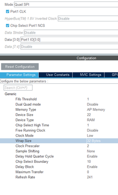

2024-08-20 2:28 AM
Hi @OGhis ,
Thank you for coming back to the community and I apologize that my suggestions did not meet your expectations.
About the settings: Device Size defines the memory size in number of bytes = 2^(DEVSIZE+1).
For 8MBytes memory the Device Size must be configure 23 as mentioned in AN5050 table8.STM32CubeMX - Configuration of OCTOSPI parameters.

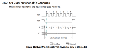

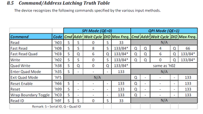

Could you please try with this sCommand:
/*Function to Enable Memory mapped mode in Quad mode 4-4-4*/
void EnableMemMappedQuadMode(void)
sCommand.AddressMode = HAL_OSPI_ADDRESS_4_LINES;
sCommand.AddressDtrMode = HAL_OSPI_ADDRESS_DTR_DISABLE;
sCommand.DataMode = HAL_OSPI_DATA_4_LINES;
sCommand.DataDtrMode = HAL_OSPI_DATA_DTR_DISABLE;
/* Memory-mapped mode configuration for Quad Read mode 4-4-4*/
sCommand.Instruction = FAST_READ_QUAD;
sCommand.DummyCycles = FAST_READ_QUAD_DUMMY_CYCLES;
Error_Handler();

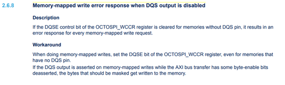

/* Memory-mapped mode configuration for Quad Write mode -4-4*/
sCommand.Instruction = QUAD_WRITE;
sCommand.DummyCycles = WRITE_QUAD_DUMMY_CYCLES;
sCommand.DQSMode = HAL_OSPI_DQS_ENABLE;
Error_Handler();

Please don't forgot to check the dummy cycle in main.h
#define FAST_READ_QUAD 0xEB
#define QUAD_WRITE 0x38
#define FAST_READ_QUAD_DUMMY_CYCLES 6
#define WRITE_QUAD_DUMMY_CYCLES 0
I hope this help you.

btw: the AP6404 has a command to put the chip in quad spi mode.
Why is this missing in your proposed source code? => AP6404_ENTER_QUAD_MODE (0x35)
2024-08-21 12:56 AM
Hi @OGhis ,
I only provided some configuration for read and write operation in memory mapped mode like that you shared, not all the code.
The SPI Quad mode enable operation command (0x35) is available only in SPI mode to switch the device into quad IO mode before enter in memory mapped:
void EnterQuadMode(void)

Concerning the 64 bit writes , there is an errata "Memory-mapped write error response when DQS output is disabled".
So with this errata we need to enable the DQS when doing memory mapped writes even if the memory do not support DQS. This is the workaround.
Now concerning products with AXI bus (OCTOSPI memory mapped region on AXI not AHB) the memory mapped write are always done in multiple of the AXI bus size (64-bit).
So when you do a 8-16-32 bit write , the OCTOSPI will output 64-bit and mask the rest using DQS pin.
The problem is if the memory do not support DQS (which is in our case), the rest of the AXI data will be written to the memory.
Please let me know if your request in answered or not?
