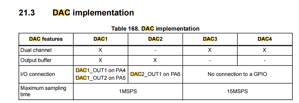

Documentation mentioned about dual chanel:
• Dual DAC channel independent or simultaneous conversions
https://www.st.com/resource/en/datasheet/stm32g431c8.pdf

Thank you. "X" means "support" ? I think it means "not support".
