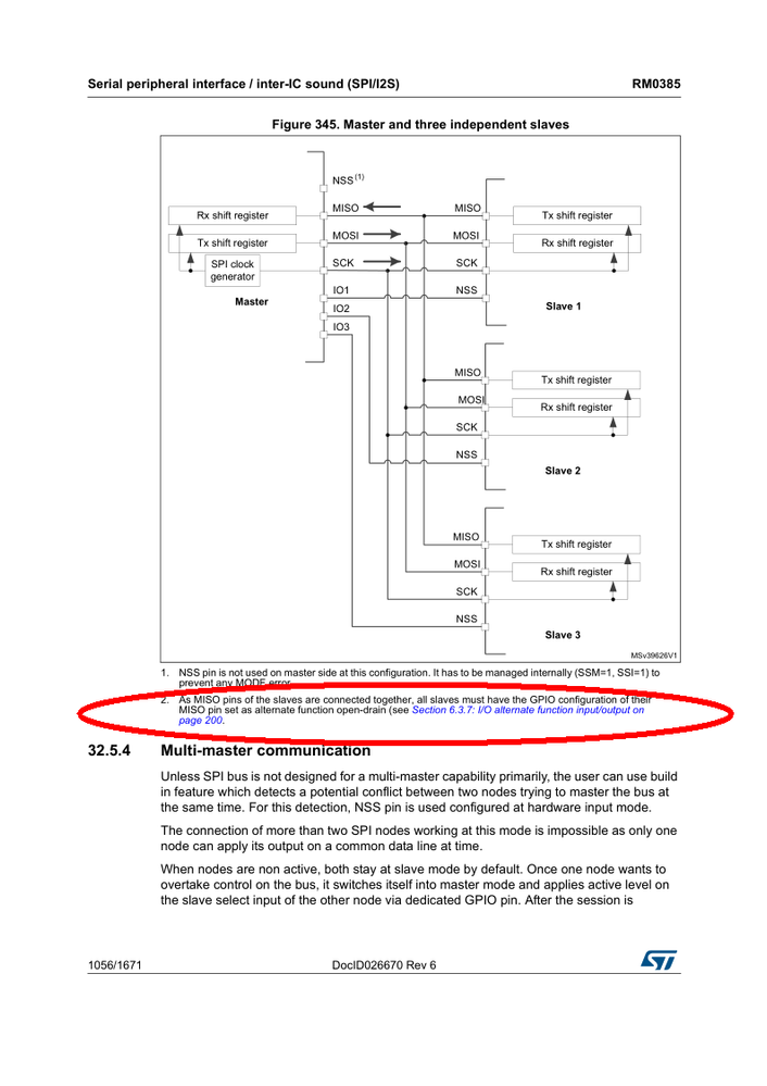

.RM0385, requests MISO being set to open-drain when multiple slaves are connected. This indicates, that NSS set to the inactive state *does not* threestate MISO in STM32 SPI set to slave, as is the custom with SPI. This makes using multiple STM32 SPI slaves not practical.
Other than this, I could not find any indication of MISO behaviour in this regard in the RM.

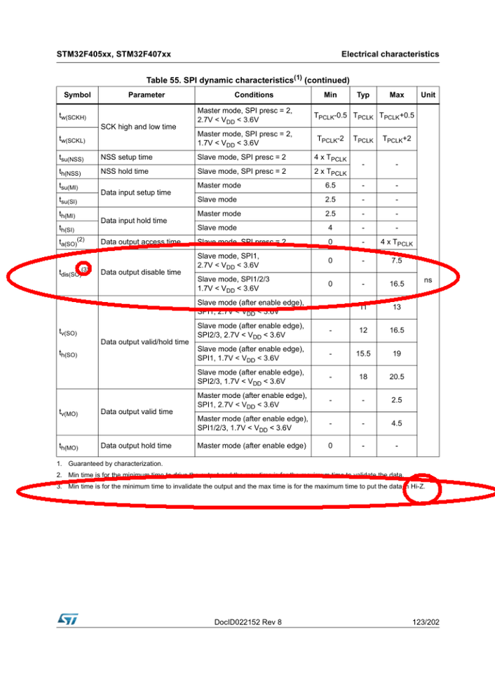

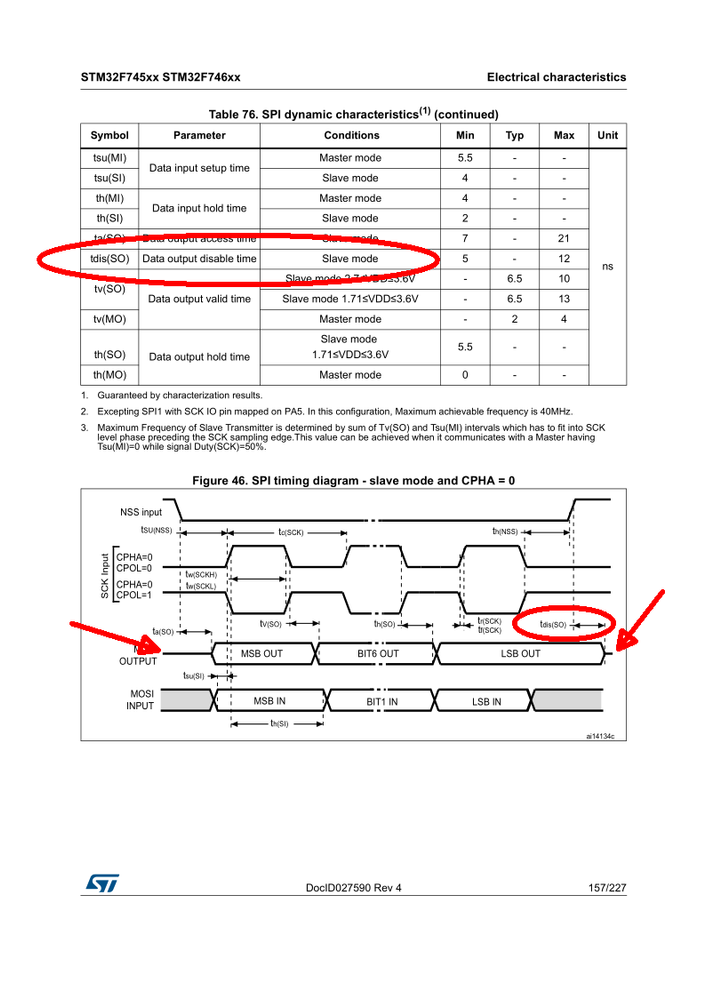

I also went to the respective datasheet and the graph indicates that MISO *does* threestate when NSS goes inactive:
The STM32F40x DS, in the same table, for the same parameter, the footnote clearly states that MISO is to be threestated (put to Hi-Z)
ST, please comment.

2017-05-18 4:03 AM
MISO signal output is under standard chip select control of NSS input when the SPI slave is enabled and configured at HW NSS mode with NSS output disabled (SPE=1, SSM=0 nad SSOE=0). This allows multi-slave star topology communication.
Best regards,
Petr
