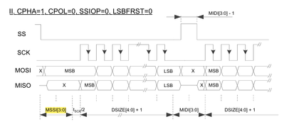

2025-09-12 6:51 AM
Increase the time between CS low and SCK pulse if the device requires this. Do this by setting MSSI to 1 or higher.
Do that here:

I should have mentioned this too at first, but I have already tried both the MSSI and MIDI (just in case) with various values, though none in the range of 0-2 make a difference in the result.

This works for me. Reference manual says it works. I don't know why it would be different for you.
2025-09-16 5:59 AM
Hello! It seems like you are right. After further testing, the problem was logic analyzer sided.
