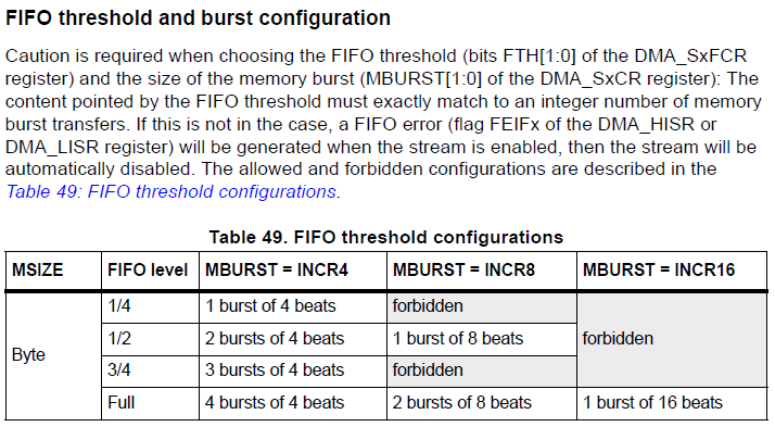

In the context of a USART perhaps, not so sure what it means with DMA, where there are two sides to the transaction (Read / Write), an uninformed guess might be that it relates to the memory alignment of one of the transfers.
2014-02-17 1:20 PM
FIFO Error != Framing Error
2014-02-17 1:34 PM
Well that makes sense, no wonder I could not make heads or tails of it. I keep looking at ''framing error''.
Thanks Clive, now I know where to start looking. I think what you wrote means something along the lines of I need to have a divisible by X number of bytes to transmit. I'm already padding out some bytes to make a CRC so it must be divisible by 4. I'll investigate more in the fifo area ! This is the code in case your curious.DMA_InitStructure.DMA_Channel = DMA_Channel_4;

I've tried several ''fifo'' modes and settings, I always get the FE along with TC. I think this is because the last bytes we transfer are not on the 32 byte boundry ?
I'm going to refactor my code to byte stuff till its %32 == 0 (instead of %4). Will take me a while but maybe it will help the DMA work :\2014-02-17 6:27 PM
I still get a FE no matter what I do. I've made sure the data I'm sending out is divisible by 32 thinking that would resolve any issues the DMA may have. There is not one example using DMA with USART for TX.
Closest I can find does this, which makes no sense to me. Why disable ?00217 DMA_InitStructure.DMA_FIFOMode = DMA_FIFOMode_Disable ;
00218 DMA_InitStructure.DMA_FIFOThreshold = DMA_FIFOThreshold_1QuarterFull ;
00219 DMA_InitStructure.DMA_MemoryBurst = DMA_MemoryBurst_Single ;
00220 DMA_InitStructure.DMA_MemoryDataSize = DMA_MemoryDataSize_Byte;
Does anyone know what my settings should be if my data is divisible by I'm currently just sending out a large chunk of around 3k bytes thats divisible by I always get a FE set with a TC. The bytes left to transfer is empty. Maybe its some one based/zero based issue.
