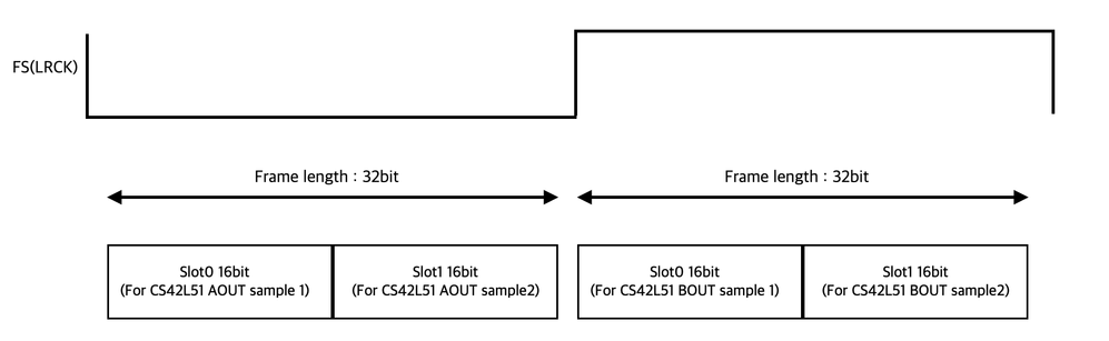

I'm implementing signal processing code.(cs42l51 audio in --> stm32 --> cs42l51 audio out)
And i'm using STM32H7B3-discovery kit.
I have some question about frame format of sai and cs42l51.
When i send sine wave data from stm32 to cs42l51, the waveform is not sine wave.(like noise)
First question is about frame format.
I'm implementing to send AIN1A to AOUTA and AIN1B to AOUTB.
I set sai setting like below.
I think I set sai frame like this. Is it right?

2022-04-23 7:22 PM
Totally no. Read the codec's datasheet section "4.7 Digital Interface Formats". And you have even invented some BOUT channels, which doesn't exist. Even the name AOUT means "Analog OUTput". A standard I2S means a 64-bit frame with two 32-bit slots, which you can fill with up to 24 bits of data.

2022-04-23 10:41 PM
hi Piranha.
Thank you for your answer.
I drew it wrong.
'For CS42L51 BOUT sample' --> 'For CS42L51 AOUTB sample'
I set the cs42l51 interface to I2S with 24bit.
Then, should I change the stm32 setting like this?
Is it right?

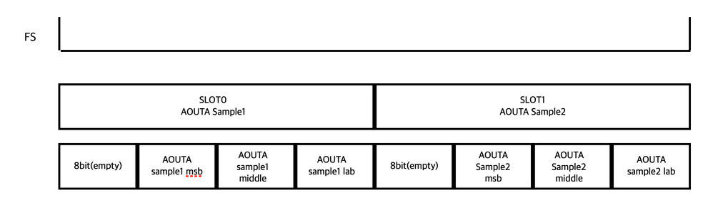

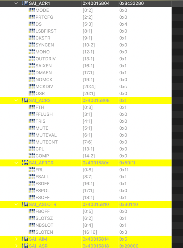

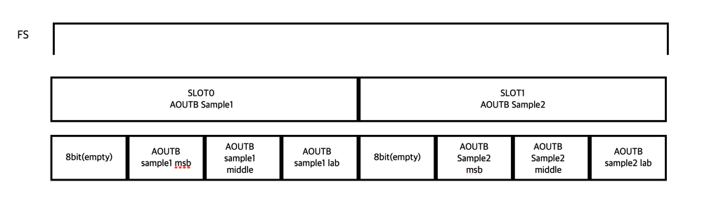

2022-04-24 1:54 AM
The register bitfield numbers are OK, just do not forget to set the DS field at SAI_xCR1 to 24-bit for your example.
But the drawing is still wrong. You have drawn a 128-bit frame with four 32-bit slots, just named incorrectly. Forget the Sample1/2 - the frame has only one sample for every channel/slot!
Also you have drawn FS signal as for I2S, but aligned data bits in a right-justified format, which the particular codec supports only for the DAC. Generally an I2S or left-justified format should be preferred, because those work correctly even if the number of used data bits for transmitter and receiver differs. For I2S the frame starts with FS at low level, but for left/right-justified formats the frame starts with FS at high level. And data bits for I2S are like for a left-justified, just delayed by one bit. These parameters are configured by FSPOL and FSOFF bits at SAI_xFRCR register.
Again - read the codec's datasheet section "4.7 Digital Interface Formats" and look carefully at diagrams there!

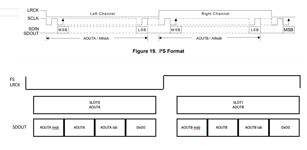

2022-04-24 3:34 AM
Slot0 : 32bit
Slot1 : 32bit
Total : 64bit
And MSB aligned left.
Is that right?

2022-04-24 7:43 AM
The frame diagram is correct now.
The data order in memory is the same as it is on the wire - frame after frame. Therefore for n+1 slots the order is:
SLOT0, SLOT1, ... SLOTn; SLOT0, SLOT1, ... SLOTn; SLOT0, SLOT1, ... SLOTn; ...
You don't have to access GPIO pins for this and the synchronization will break anyway. The DMA interrupt with it's status flags already tells you which interrupt it is - half or full transfer complete. Use that information to decide on which half of the buffer to process. Alternatively you can use double-buffer mode (RM0455 section "15.3.11 Double-buffer mode"). It has a few advantages, but both approaches are viable.
