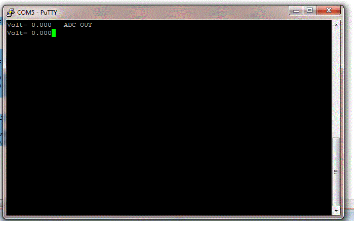

Dear All,
Some thing wrong with DMA operation please advice/* Includes ------------------------------------------------------------------*/

Result is zero

Dear baird,
Thanks for the reply Your catch is correct but the result is the samewhile(1){
