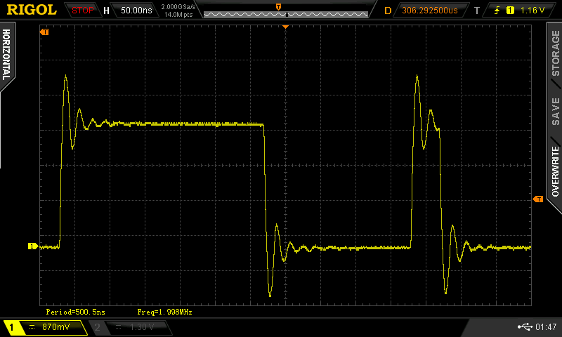

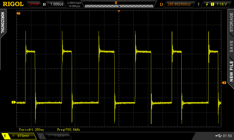

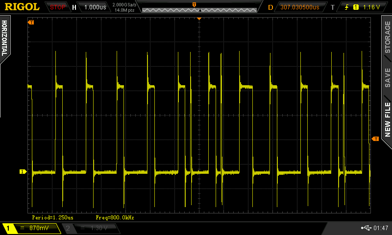

Hello all, I'm trying to run a ws2812 strip using a timer and DMA. I'm using the stm32f303vct6 chip at 48MHz.
The Timer is running with no prescaler, and no clock division in PWM1 mode, with a period of 60 (1.25us), for a data rate of 800kHz.For ws2812, the data is sent with 1 being longer than 0 - basically I modify the compare value with dma to get the correct output.Currently it works, for the most part, if I use a compare value of 26 for HIGH, and a compare value of 16 for LOW. However, this timing isn't perfect, and doesn't seem to work with all ws2812 LEDs. If I try to make the LOW shorter, say, 14, or the HIGH longer, say 28, weird things start happening in the output. The 1s have spikes in them.This picture shows what I see if I use 16 and 26:2014-10-20 5:26 PM

Drop this to 1 or 2MHz, it will ring less
GPIO_InitStructure
GPIO_Speed
GPIO_Speed_50MHz

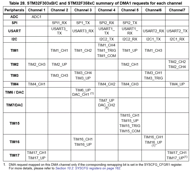

For the chip the Reference Manual covers DMA function/connectivity, and the Data Sheet the pin availability. This table should illustrate the TIM to DMA channel associativity.2016-11-23 9:26 PM
