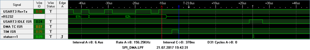

To reproduce the original issue, I took a
; took the bulk of your sources (rewrote the intro of course as I despise Cube :) ); to simulate your transmitter I employed Tx of the same USART3, filled by DMA in the main loop, followed by a trivial loopdelay; shorted PC10 to PC11 on the DISCO by a jumper for loopback; removed printouts, added several pin toggles to follow the execution path.(I also had to randomize somewhat the timer ISR, as for certain code length it got inadvertently synchronous with the USART/DMA process, hiding the problem - see below for the role of the timer ISR).
I can confirm your initial finding: the Rx DMA with 4N+k, k=1..3 bytes to transfer, switched-on FIFO and word-transfer on memory side, occasionally ends with NDTR = 0 and TCIF *not* set.
