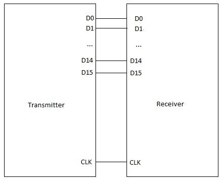

I want to transfer some data between two microcontrollers via 16 lines of data and one clk line.
(Based on STM Application note AN4666 ''Parallel synchronous transmition using GPIO and DMA'').
I use two STM32f407 for this Application.In transmitter side micro puts 16 bits of data on port when clk line goes high(Rising edge).In receiver side I want to read 16 bits of data from Port when clk line goes high and put theminto Tx_Buff array via DMA.
I want when the rising edge of clk has been detected by Timer8-CH4(PC.9) -which configured in input capture mode-it acts as DMA trigger for transmitting the 16 bits data to TX_Buff.
Finally I expect DMA Interrupt occurs when 750 transfers completed.While testing, the Transmitter side works fine (clk and data) and I monitored them in Logic analayzer and the Timer works fine too, but the problem is DMA not triggering (I'm sure of it because I check the registers) so as follow, no interrupt occurs in receiver side.
