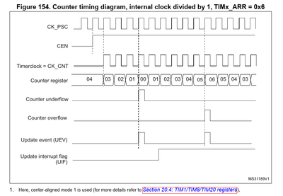

Center aligned mode counts up and down - so double time (62 -> 124 us ) , as "normal" pwm mode.

I am not sure (i never tried) - see description , as i posted.
But i would try mode 3 - tell, what comes out. Because mode 3 (as i understand description) is true center mode, ccr compare on rising + falling counter. Mode 2 only on rising...
