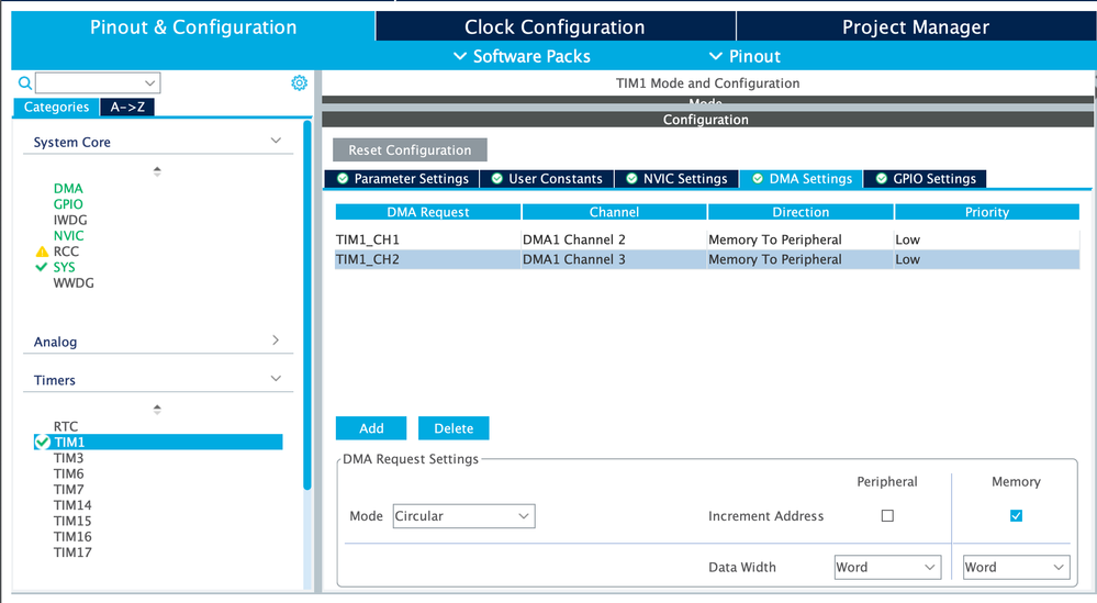

about your program:
- set DMA in Cube to half-word / half-word transfer data size .
- leave away (for test , now at first ) the //HAL_TIMEx_PWMN_Start_IT(..); lines .

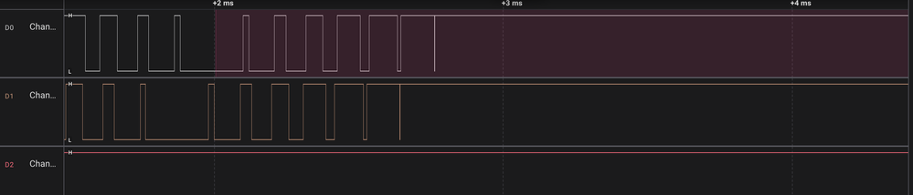

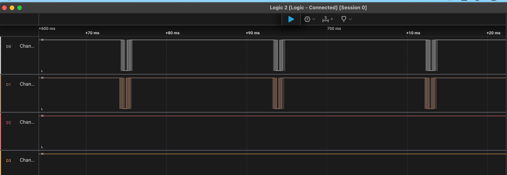

2024-05-02 1:06 AM
Thanks
Now i can get only 12 ON pulses, am giving 160 varying valuse from Lookup table for duty cycle .
62.5μs×160=10000μs =10ms
But not showing 160 pulse ,is it due to small variation in the duty cycle ?
sorry for my bad english

Which STM32?
Read out and check/post content if TIM and relevant DMA registers.
PS. Don't @-invoke users unnecessarily.
2024-05-02 1:51 AM
Stm32f070RB Nucleo Board

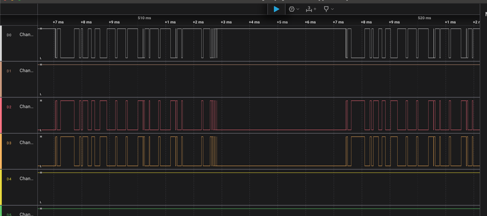

2024-05-02 2:00 AM
Aaaaa, come on: set ARR to max. used value in ccr loading -> 255 . Try.
2024-05-02 3:54 AM
Nice catch, @AScha.3

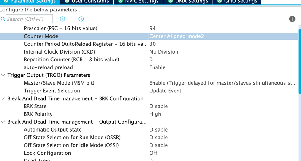

2024-05-02 6:11 AM - edited 2024-05-02 6:13 AM
Thanks

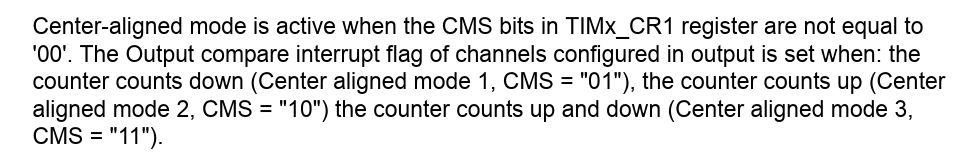

When I select Centere Aligined mode1 ,which is not giving output ,when i select Centre Aligned Mode 2 it is working
why ?
2024-05-02 6:21 AM - edited 2024-05-02 6:22 AM
Well, i need to read the rm , to know the difference - so i recommend read it in rm of your cpu. :)
from F303 rm :

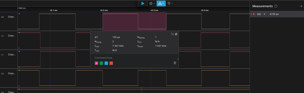

2024-05-02 6:38 AM - edited 2024-05-02 6:39 AM
I got expetced pwm But the PWM period is expected is 62.2micro second (Fpwm is 16khz)
but the output shows 124 micro second please see the image
why ?
