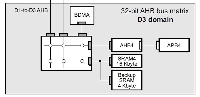

I don't really see enough initialization here. CubeMX buries and obfuscates, so makes for bad examples.
Try using SRAM4 in the AHB4 / APB4 / D3 Domain for the memory buffering

Not my tools, but generally GNU/GCC would be via the linker script and __attribute__((section(".sram4"))) type construction
If it's not part of the memory visible to the linker, your could test with a simple pointer assignment.
uint8_t *Buffer4 = (uint8_t *)0x38000000; // 64KB at 0x38000000
2021-12-06 3:46 PM
Ok,
I found this article:
https://community.st.com/s/article/FAQ-DMA-is-not-working-on-STM32H7-devices
And now have the DMA working on lpuart1. I added the following to my linker script: STM32H753ZITX_FLASH.ld
