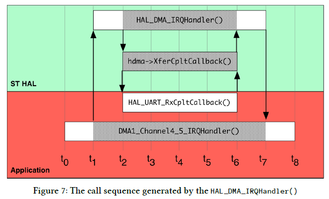

Hi the example is below.
In this example he is using the function HAL_UART_Receive_DMA which belongs to the HAL_UART module.
He specially raccomands to enable the UART related interrupt and call the HAL_UART_IRQHandler() routine from its ISR.
In a previous example he does the same job but using instead the HAL_DMA_Start_IT function(he is not using the HAL_UART module),
and he doesn t enable the UART related interrupt.
So i suppose he enables the UART interrupt when using the HAL UART module function HAL_UART_Receive_DMA.
But WHY?? i know the answer is here but is not clear to me.
Thank you very much for help!

//This callback is automatically called by the HAL when the DMA transfer is completed
void HAL_UART_RxCpltCallback(UART_HandleTypeDef *huart) {
dataArrived = 1;
void DMA1_Channel4_5_IRQHandler(void) {
HAL_DMA_IRQHandler(&hdma_usart2_rx); //This will automatically call the HAL_UART_RxCpltCallback()
The author writes:
when we use the HAL module for a given peripheral (HAL_UART in this case), we do
not need to provide our own callbacks: they are defined internally by the HAL, which uses them
to carry out its activities. The HAL offers us the ability to define our corresponding callback
functions (HAL_UART_RxCpltCallback() for UART_RX transfers in DMA mode), which will be
invoked automatically by the HAL, as shown in Figure 7. This rule applies to all HAL modules.

There is no UART interrupt in this example.
Only DMA TC interrupt, which notifies you when the buffer is full, i.e. the configured number of characters received.
Which you probably want, if you have just one DMA buffer.
