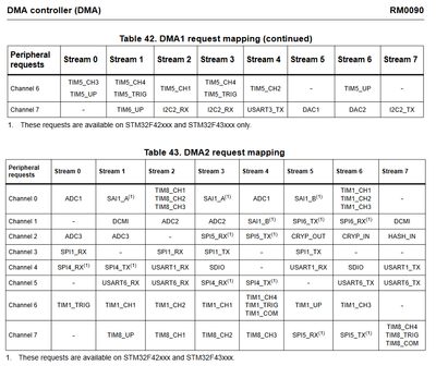

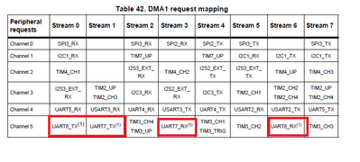

What is the meaning of These requests are available on STM32F42xxx and STM32F43xxx only for DMA1 and These requests are available on STM32F42xxx and STM32F43xxx for DMA2.
What should ı use for the mapping ?

CDR on which ADC? as I said, each one has its channel and stream as shown in the table.
@tinkerer_of_universe wrote:
Does this sentence have no relevance to STM32F407
This note is related to some peripheral mappings:
So these requests are available only on STM32F42xxx and STM32F43xxx products.

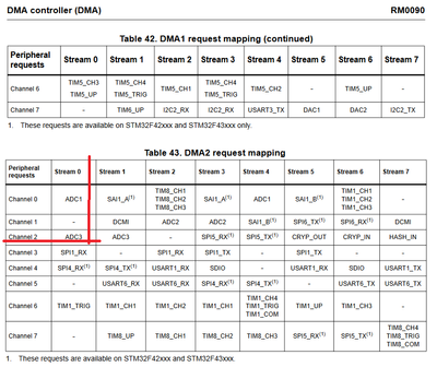

For example, if you want to trigger DMA transfer using ADC3 end of conversion, you need to select Stream 0 / Channel 2.
Example from HAL:
hdma_adc.Instance = DMA2_Stream0;
hdma_adc.Init.Channel = DMA_CHANNEL_2;

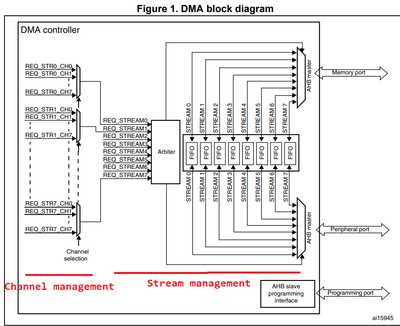

For more details, please review the AN4031 "Using the STM32F2, STM32F4 and STM32F7 Series".
DMA controller
Figure 1. DMA block diagram

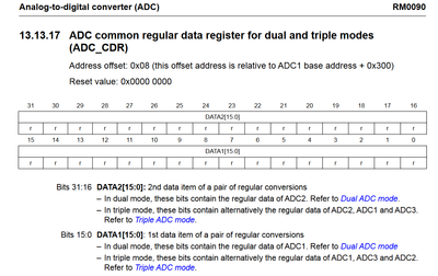

ı use dual ADC mode and ı want to carry 2 data(ADC1 and ADC2) with DMA at the same time that is why ı want to use CDR register

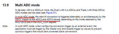

In multimode (Example Dual mode) ADC1 is master to the ADC2 and ADC3 slaves.
From the reference manual:
So in that case DMA will get the request from ADC1, i.e. DMA2 Stream 0 / Channel 0 as per table 43.
You can also check this example (ADC in Dual mode) :

Thanks for the ADC information. I understand more clearly than before. I chose Dual mode. I guess your suggestion is usable for Triple mode. However, I can't see how to transfer the CDR register data using Table 43. I want to use just one address (CDR), but the table includes ADC1, ADC2, and ADC3, which is why I'm confused.
