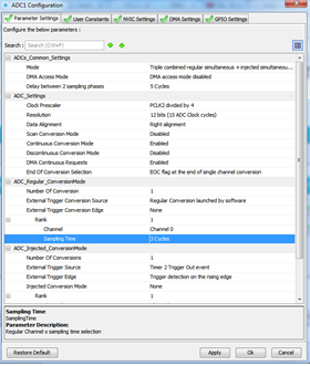

I configured the cube as folllows:

,With the help of RM0390 'STM32F446xx advanced ARM®-based 32-bit MCUs' document, I have set up the use-case for 'Triple combined regular simultaneous + inject simultaneous mode' with 2 regular channels per ADC and one channel for injected with ADC1.
'Scan Conversion Mode' is set to 'Enabled'.
'End Of Conversion Selection' is set to 'EOC flag at end of all conversions', i.e. the EOC bit is set at the end of each sequence of regular conversions. Overrun detection is enabled only if DMA=1.'DMA Continuous Requests' set to 'Enabled', i.e. DMA requests are issued as long as data are converted and DMA=1.
'Sampling Time' is set the same value for each channel.
'DMA Request' is added for ADC1 as master in 'DMA Settings', with corresponding interrupt handler function, i.e. 'DMA2 stream0 global interrupt' in 'NVIC Settings' for 'ADC1 Configuration'.
DMA 'Mode' is set to 'Circular' for 'Peripheral' to Memory with 'Data Width' set to Word (32bits).For ADC1 for example, a channel is added in 'ADC_Injected_Conversion Mode' and 'ADC1, ADC2 and ADC3 interrupts' is 'Enabled' in 'NVIC Settings'
