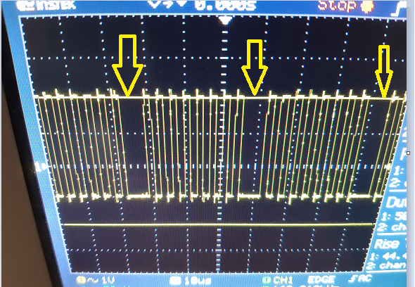

I need to transfer 42 pulses (with 1 pin of a port) and read incoming bits from 1 pin of a port( such as SPI communication). As this forum member trained me I am curious to use DMA to generate 42 pulses with sending a specific value(10101...). I need to know
1)Is is possible to couple DMA with GPIO(one pin?)
2)Is there any delay between each byte(Such as SPI)?
3)Could you provide me a sample ?

To answer the 2nd question,
SPI should transmit without gaps if the transmit register is properly handled, but I'm not 100% sure of that.
The timer won't make any gaps, it is designed to generate equally timed periodic events. If you want to have a gap, include it in the bit pattern to be sent.
