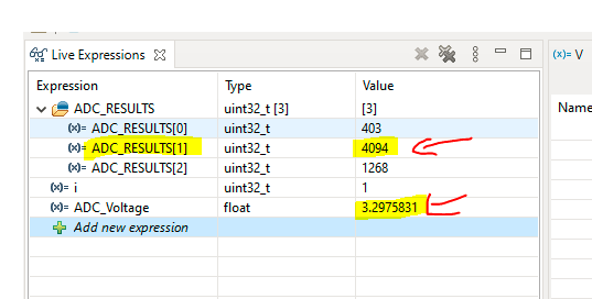

2021-11-02 4:19 AM
ADC_CHANNEL_X ( X -> 1,2,34.........16) all are working without the initialization of GPIO pins.
We are getting the digital values for every 0.8mV ( 3.3/2^12). vref is 3.3 and 12 bit resolution. we verified it by connecting Potentiometer to the ADC_CHANNEL_2 .

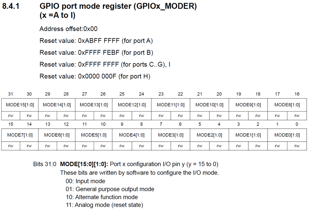

Is the ADC_CHANNEL_X ( X -> 1,2,34.........16) enabling the GPIO pins internally ?
What is the default mode of ADC Pins ?
2021-11-04 6:36 AM
The default mode of pins is given in the reference manual under the relevant GPIO register settings.
For this chip and other newer chip families, most pins are in analog mode after reset. That would explain what you're seeing.
