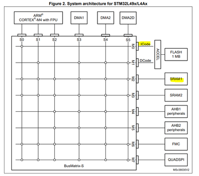

Hello @IIvan.22
This can be understood by looking at the system architecture for STM32L49x/L4Ax
When SRAM1 is remapped to zero-based address, the CPU can access the external memory via ICode bus instead of System bus which boosts up the performance, as you can see, DMA controllers cannot access the Icode bus.
If you're looking for high performance, L4 is not the optimum choice as it's dedicated for low power applications
