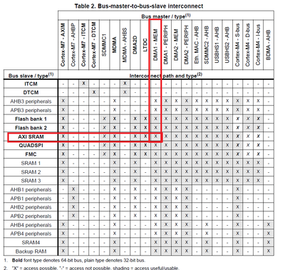

See the reference manual Table 2:
DMA1 has access to AXI-SRAM. So, you can do data transfers from/to AXI-SRAM with DMA1.

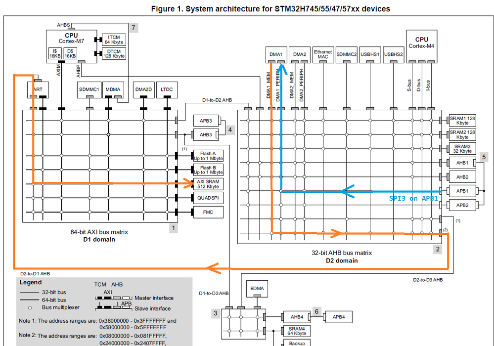

And this is the transfer path from SPI3 to AXI-SRAM using DMA1:
