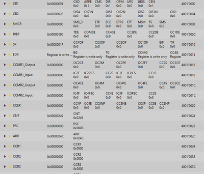

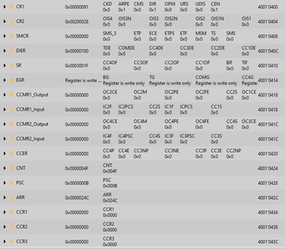

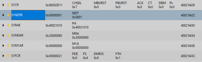

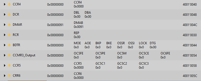

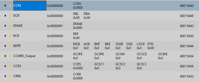

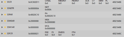

After the crash the following DMA and timer configuration are shown:
DMA2:
TIM1
TIM8
Whre come this crash? If it a problem with the timing otself? Booth timer have the same timing.
Thanks for our help,
Bernd

Registers look OK.
The crash is outside of what you've shown us.
TIM1 just rolled over (or under - choosing downcounter is weird, and also are you sure you want to set up TRGO/TRGO2? they are harmeless now but not needed for this exercise either) as witnessed by it CNT, and DMA2Stream just triggered a Transfer Complete as witnessed by NDTR and the flags in HISR. As the flags (namely TC) is not cleared and you have interrupt on TC enabled, the crash is most probably consequence of the interrupt, most probably incorrectly handled.
Check - best in mixed C/disasm view - that the proper vector to the ISR is inserted to proper position inside the interrupt vector table. If not, check if the ISR name matches exactly (noting that C is case sensitive) that in the vector table (usually in the startup code; the interrupt chapter in RM contains the reference list of interrupt vectors). If you use C++, mind name mangling.
