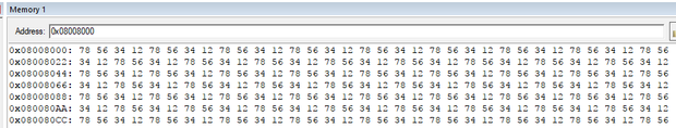

Hello I am looking at the STM32F429 Discovery board Flash memory sample source as below.
I'm recording Hex values in flash memory.
The sample is to be input with a value of 4 bytes Hex ((uint32_t) 0x12345678). Tell me how to write text (hello world) and date (2017-11-09) to Flash memoryThank you.
Have a nice day!!

After writing text and date in flash memory
Lead Text and date, move to buffer or variableI want to write to usb stick memory sequentially.If you have a similar sample, I would appreciate your support.
