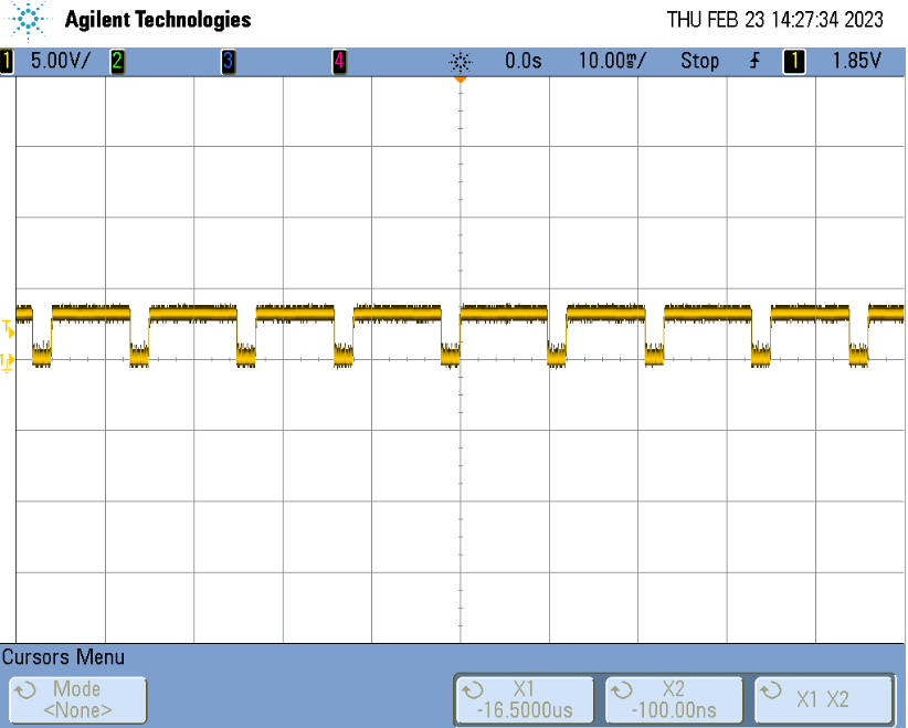

However, this pin appears stuck low when I try to receive data on it (all zeroes). I am using a RS232 to TTL converter board to send data to it. If I remove the wire from the converter to PA3, I can see the correct data from the converter board. But as soon as a solder it back to PA3 all I get is zeroes. I config'd the UART with MXCube; note that UART1 is working fine.

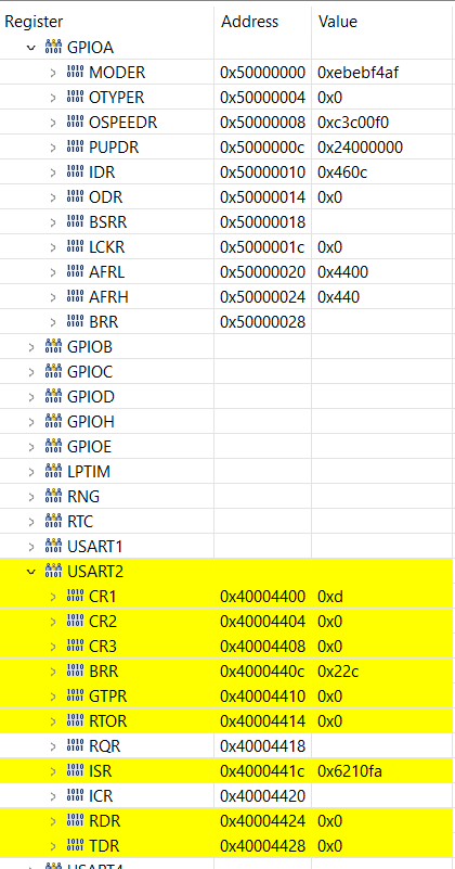

2023-02-24 10:07 PM
In debugger, read out USART registers and GPIOA registers, and post what you read out.
2023-02-27 8:09 AM
This is the contents of the GPIOA and UART2 registers when I am receiving all zeroes on UART2. I set a breakpoint in the HAL_UART_Receive_IT routine just before the function returns.
