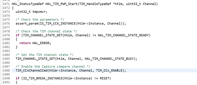

2024-11-08 8:32 AM - edited 2024-11-08 8:43 AM
Hello, had a similar issue. Anyway I found out CCER regiser sets in TIM_PWM_Start function calling TIM_CCxChannelCmd function.
You can find TIM_CCx_ENABLE equals 0x1 and it doesn't change by built-in configurator. You can recalculate register value and put it there to make the driver operating fine according to the rm0454(item 19.6.8 TIMx capture/compare enable register (TIMx_CCER)(x = 16 to 17)). Since the 0x1 match the settings for CH1, direct PWM option works fine.So just change the TIM_PWM_Start function in xxx_tim.c. or change the CCER register after calling the TIM_PWM_Start function.
