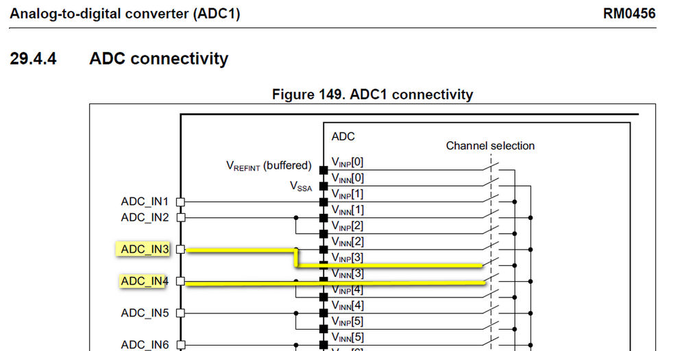

I am having some difficulty configuring STM32U575 ADC1 for Differential inputs.
The reference manual and auto-generated code seem to have conflicting information:
The ADC1 Connectivity diagram from Reference Manual (below) indicates configuring Channel [3] as differential will use ADC_IN3 to VINP (+ve) and ADC_IN4 to VINN (-ve).

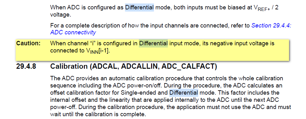

Further down in the manual a note re: differential channels:
The Caution note conflicts with connectivity diagram. It would suggest that when Channel 3 is configured for differential mode, then the +ve goes to VINP[3] and the -ve would go to input VINN[2].
The auto generated LL code from the IDE is another story.
The ADC init function first initializes ADC1_IN3 and ADC1_IN4. (matches the ADC connectivity diagram....so far so good)

LL_ADC_SetChannelSingleDiff(ADC1, LL_ADC_CHANNEL_4, LL_ADC_DIFFERENTIAL_ENDED);Documented for helper macro LL_ADCAetChannelSingleDiff() has this note:
* In differential mode: Differential measurement is carried out
* between the selected channel 'i' (positive input) and
* channel 'i+1' (negative input). Only channel 'i' has to be
* configured, channel 'i+1' is configured automatically.
This note would indicate that the configuration should be applied to the +ve input....so the initialization code would not be correct.
Can anyone confirm if the connectivity diagram from the reference manual is correct?
