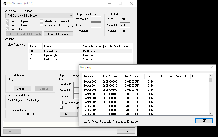

I have a Problem with the DfuSe Demo (v3.05) and the STM32L073CZT on chip bootloader.
It is not possible to upload or down Load from/to the InternalFlash.
Downloading or Uploading the DATA Memory is possible.
I have tried it with our own borad and a nucleo board both the same problem!Does
anyone knows what the problem is?
Is it a Problem from the STM32L073CZT chip or from the DfuSe Software?edit(26.09.16):
today i tested it with the DFU Tester (v3.0.1).
there the Flash is also shown as not readable writeable.
but it is possible to write or erase the Flash, also leave dfu mode works.

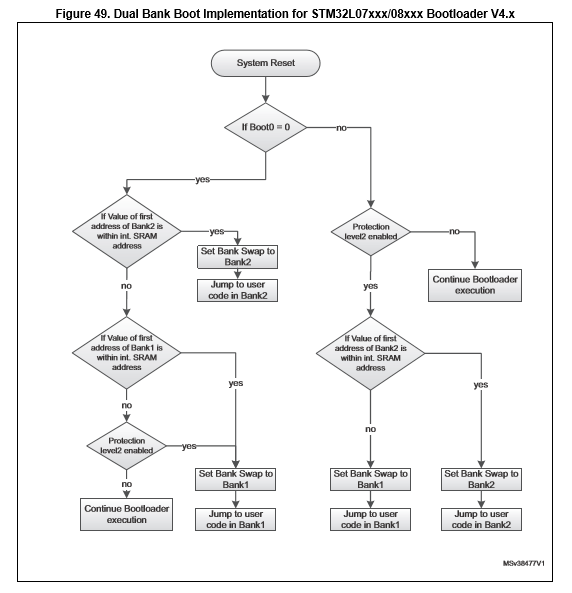

the boot pin s are so configured that the SMT boots from System mem. (nboot1 is checked (standard (
factory
) config ) and boot0 pin is connected to Vdd ).the BFB 2 bit is in standard (
factory
) config (because i am currently not at work i can?t say itexactly but i think it is checked
) .(we would have connected Boot0 to vss but the left tree form fig.49 form AN2606 won?t work it never end in the bootloader. so we have connected boot0 to vdd and I hope we can kill the repeatedly starting bootloader by enabling Protection Level 2)

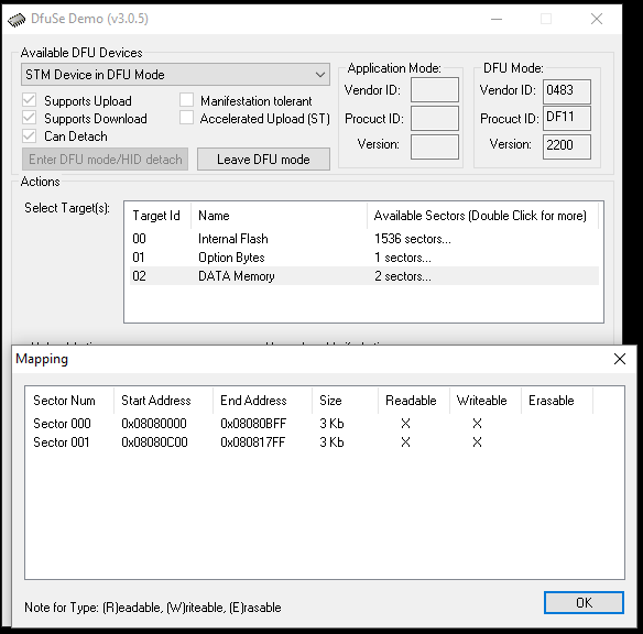

We use DfuSe Demo 3.0.5, and have same problem with STM32L073CZ. When click to ''Upgrade'' button PC app very quickly (around 3 seconds) do programming and say that all Ok. But after click on ''Leave DFU mode'' don't work. See picture. STM32 is stay in DFU mode.2016-10-31 1:45 PM
