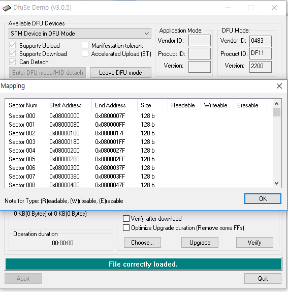

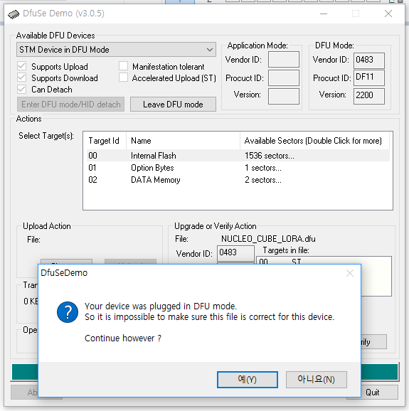

Dfuse Demo (v3.05) does not download firmware properly.
The error message is shown below.

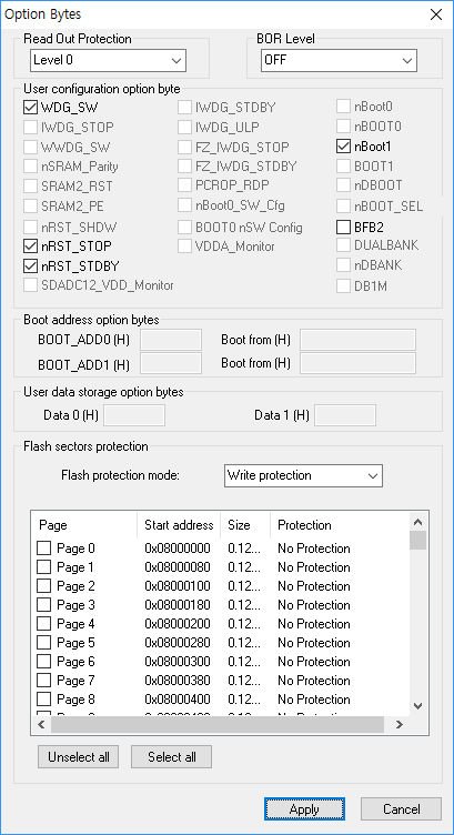

The following image is the contents of the option byte.
There is no revision.

Well the error you've provided just indicates you have a generic STM32 L0, which can't be differentiated from millions of others, or thousands of other customers products using an L0, and not with some unique VID/PID to you as a customer.
