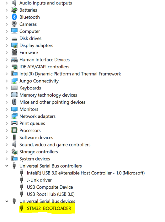

Yes, i already done that , when i check on my Device manager it shows STM32 BOOTLOADER instead of STM32 in DFU MODE under USB device

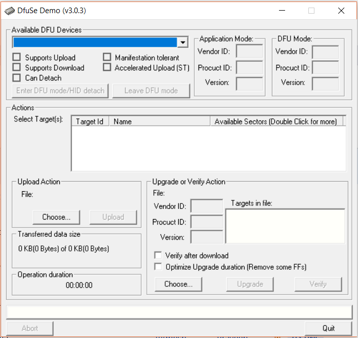

can you make a screenshot from dfu demo?
2018-10-24 7:54 PM
Thank you, Attached here are the images , the dfu demonstrator does not recognize the board and does not display the board info.
