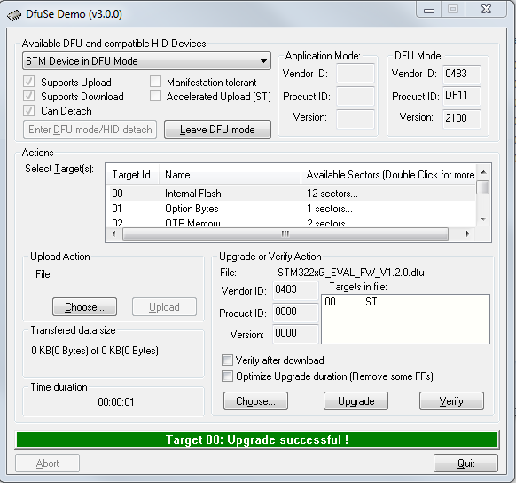

I have installed DfuSe Demo (v3.0.0) . On connecting a STM3200G-EVAL board & setting the boot options & then pressing reset, the program says I am in DFU mode and gives the Vendor Id 0483 and the Product ID DF11 and Version 211 all OK. I can select a DFU file without problem.
however, when I press Upgrade or verify, the software says it works, (see below) but does not actually seem to do anything. The original software is still present.2013-03-15 10:15 AM
Can't say I've had such issues with DfuSe, suggest you use ST-Link, or something, and nuke the flash from there, then confirm that DfuSe is writing something, and then if it's what you expect.
Alternatively make your own DFU file, and burn that, knowing the location the code is situated.2013-08-05 7:42 AM
