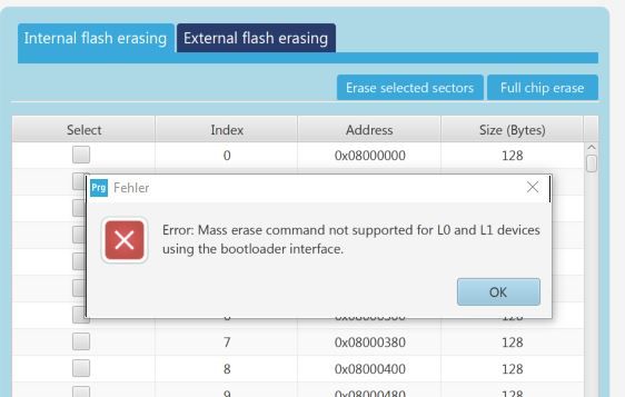

Dear Aymen,
sadly Full Chip erase is NOT supported for L0 and L1 devices using Bootloader interface! Thats why its not possible to programm the device. The developers for STM32cubeProgrammer forget to include a Button which selects all Sector Index checkboxes to be able to do use the singe sector erase for all sectors.
in order to do a full chip erase the only working workauround L0 L1 devices is to select and then deselct the Read out Protection Flag, which will do a chip erase after deselect ROP flag. Performing that procedre it is possible to Programm L0 L1 devices via USB

Hi Alexander,
Please try to do a mass erase before launching hex programming.
