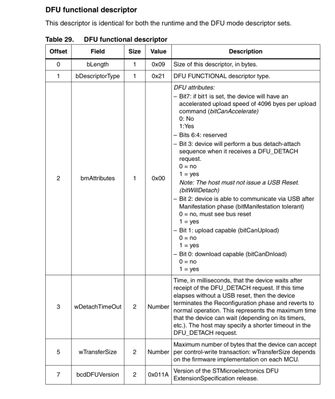

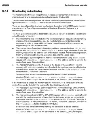

Dear @newtocube5 ,
Can you check the DFU functional descriptor and the transfer size is implemented in the embedded Firmware as described here :
let us know .
STOne-32
2025-10-02 1:03 PM
Dear @newtocube5 ,
let us know .
STOne-32
2025-10-02 2:04 PM
I am new sorry I didn't realize I could get this device information. Okay I have successfully acquired this info, and it appears the default is in fact 1024 as I suspected. Thanks for the Help!
