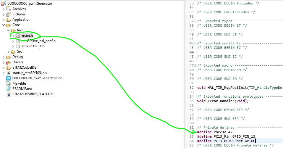

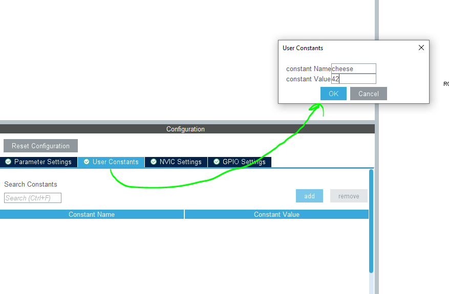

> I was aiming for solution that would work on any project, without customization; sort of library code.
You can add custom defines to Cube-generated project and make some convention with the library code.
For example you can define a UART number and baudrate that the library should use.
Also as KnarfB wrote, user-defined pin names can serve for this.
