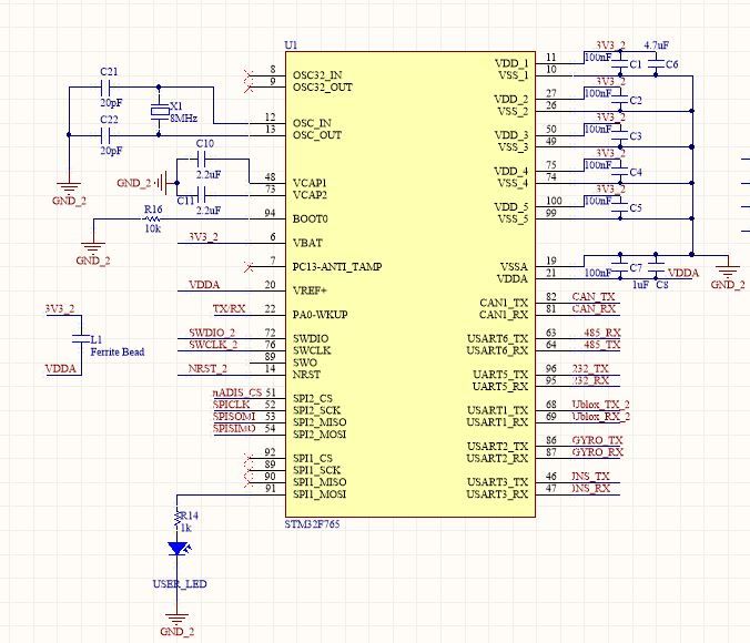

Hi ! I have designed a board with stm32f765 (LQFP100) but I got a problem with it when I test this board. I connect the board through usb cable with st link v2 and the ST Link Utility can detect this stm32f7 but when I download the code from Keil C to it, the stm32f7 got damaged because I find that vdd and vss pin are connected inside the chip. I try to find the reason and I think the reason is I don't configure for Boot0 pin. So I design another board with schematic image below. Can someone tell me that it is correct schematic ? I don't want to be failed again. Thank you.

application note
gives you minimum requirements you have to take care of for proper hardware design.Best regards,

Thank you ! I will check it again
