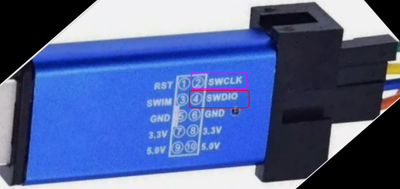

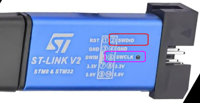

Indeed, to be fair, I have used clones in the past and they have worked.
Another thing to beware of is that clones which look identical might have different pinouts!
Addendum:
And some users have reported that the RST (Reset) does not work for STM32 (only STM8):

Clones (I mean of the type shown in the pictures andrew posted) also do not provide a SWO pin (without modding) needed for "Serial Wire Viewer" (SWV) debug functionality with CubeIDE, which is a very useful feature to have during development.
