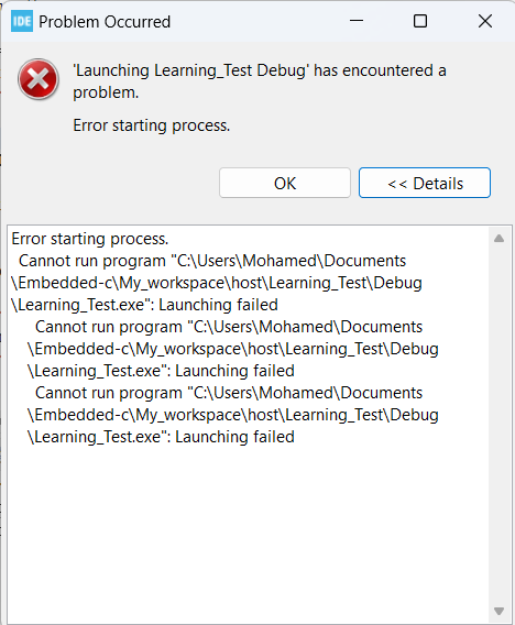

I am Trying to run a simple c code on STM32CubeIDE Through
Project --- Run as --- C/C++ Application
But i am always getting the following error:
OS : Windows 11 Pro

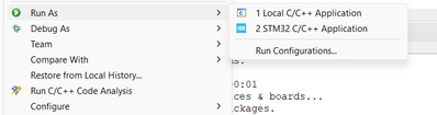

My understanding is that: "local" means to run this generated code on the host platform, the PC, e.g. as a Windows program. This cannot work.

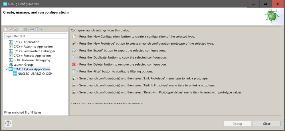

You have to create a Debug Config using the external STM32 board. Use this debug config and run the code on the MCU.
I think, the IDE is Eclipse based and it is potentially possible to create also code for the host PC, e.g. if you need a counterpart program running on the Host OS. "local" means "running at the host OS".
Check, if you have a debug config as "STM32 C/C++ Application" and select this as the 'target'
