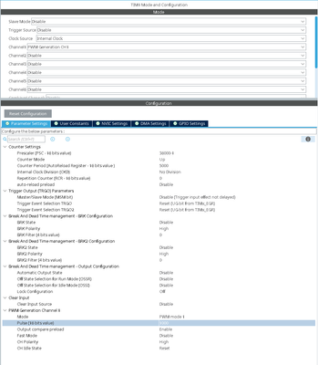

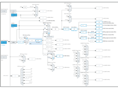

Hope you're well. I used CubeMX to setup a PWM timer on the STM32F3 discovery board and tried to perform some debugging to study how the registers changed(GPIOE and TIM1). The timer setup and initialization works as expected. LED blinks with output of duty cycle. However, when I tried to debug with different tools such as openocd, Clion, vscode+cortex-debug extension, gdb or CubeIDE, I step line after line and I'm stuck with setting a breakpoint after the clock configuration function (SystemClock_Config();) and cannot view the registers- Timer 1 especially(SVD view). All other lines of code cannot be stepped into after this line. The debug session infinitely continues.
I dug around to understand what could be the cause and my understanding is that since I am only initializing a timer peripheral and there is just the empty while loop, gdb sets a breakpoint at the reset handler. Nothing really happens after I continue the debug session. The only IDE that lets me see the peripherals in real time is Keil. Also, please correct me if i am wrong, the HAL could also point to the reset handler if something goes wrong with initialization of peripherals.
SO, my question is how can I view register data and debug step-by-step with IDE (CubeIDE) if I am just using a timer and an empty loop? Or if there is truly a problem with my code that prevents debugging, what resource is available from ST to study how to properly debug and figure it out?
