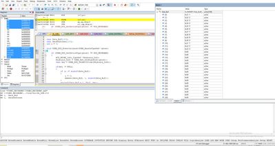

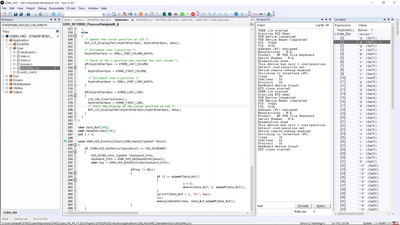

I am facing a problem in implementing USB HID host input for keyboard.
I can get only 12-13 characters in my buffer after which the keyboard doesn't respond to any input as can be seen in snap attached.
source for keyboard handling is also attached

Hi Team,
Apologies for the delayed response. I have been delegated the project from @Manas_Gupta ,I did try the solutions you suggested regarding USBH_MAX_EP_PACKET_SIZE and USBH_MAX_DATA_BUFFER, but unfortunately, they did not resolve the issue. The keyboard still cannot register more than 12 keys at a time.
