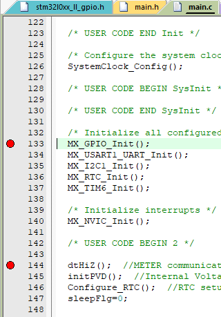

This is my code. I can stop by line 133, can reset, can run again. If I put a break point at line 134, I can not stop the debugging, but my board works well... Line 133 to 140 is made by Cube-MX.

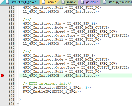

This is in the MX_GPIO_Init(). I can stop line 667, almost last part of the function but If I step next, I can not stop the debugging...

PB3 is connected to a FET gate. This is the same hardware design that I made already many times and working well except this project.
When I disconnect PB3 and FET physically, I could stop the debugging. Why...???
PA8 is also connecting to a FET gate and the MX setting code seems the same as PB3 setting. But PA8 doesn't have to disconnect, and I can stop the debugging...
2018-02-28 8:04 PM
PB3 is the SWO pin of the debug interface, although not used on CM0/CM0+ devices to the best of my knowledge.
2018-02-28 11:48 PM
Thank you Clive and Ava!
I don't use SWO line but I should not use PB3.
